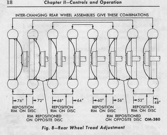

Deanostoybox has the answer below. You need a 60 inch tread setting for 30 inch rows. Might be easier said than done though if bolts/rims are rusted. Which they probably are.

The 60 inch tread is what you need for 30 inch rows 72 inch tread was used for 36, 38 or 40 inch rows as wheel tread only went to 72 inches so had to use a wheel tread that did not fit center of rows on the wider rows. And the 52 inch tread is what you plow calls for. And Dad did not use that guide in cultivating, he just used the corners of the hood to guide him. I wanted a set of thre front mount so bad but when a set came up for auction I did not have enough $$$$$$ to get it. And be sure the leveling box on the 3 point arms are set equal in not the cultivater will want to pull sideways.

deanostoybox
01-27-2023 18:03:03
Report to Moderator
 Re: Cultivating corn with 8n in reply to chris laube, 01-26-2023 16:24:02
From the 8N operators manual
Third Party Image

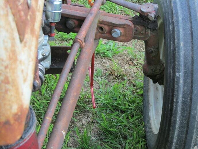

I helped grandpa many years getting the 8N ready for cultivating corn. First we spread the tires. Realigned the front tires. Mount the cultivator. Then put the marker on the front axle. The marker is what you watch to keep the cultivator aligned with the rows. Without it you will surely cultivate the corn rows. Also you will need shields to protect the corn rows, for the first few times, from flying dirt when they are under 6 tall. After that you can lift or remove the shields so the dirt flys between the rows to cover any weeds that may be there. Make sure there is a disc blade in the center of the cultivator. That will prevent side to side motion of the cultivator which would be devastating to the corn. Third Party Image
Row marker in bright red.
