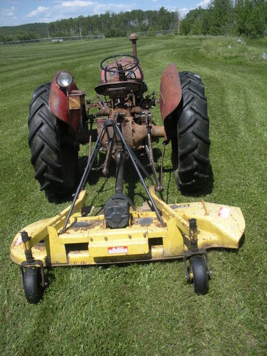

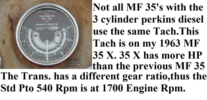

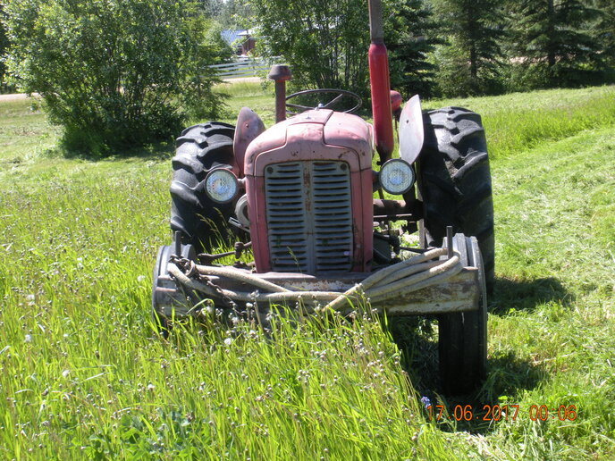

My 1963 MF 35 X 44 HP.. 3 cylinder Perkins Diesel @ Standard PTO is Just over 1 MPH in 1st gear Low range...
With 24 rear Rims, I have no problem with one of my 5 Cutters..
No problem with a 5 foot rototiller in the Garden spot..
Pic of MF 35 X was running cutter in 3 rd gear low range and or 1 first gear high range at standard PTO speed .:)
Ferguson TEA-20 is useless on the same PTO driven equipment....NO live PTO and no slow rears..
Ferguson TEA-20..Great for Grass Groomer in Cemetery ..
Same said for my 2-N.....Great for Grass Groomer in Cemetery ..
Tea-20..TO-20..T0-30..9-N..2-N...8-N...light on the front...
NO live PTO....
Transmissions have no real creeper gears..
All the best on your decision...:)
