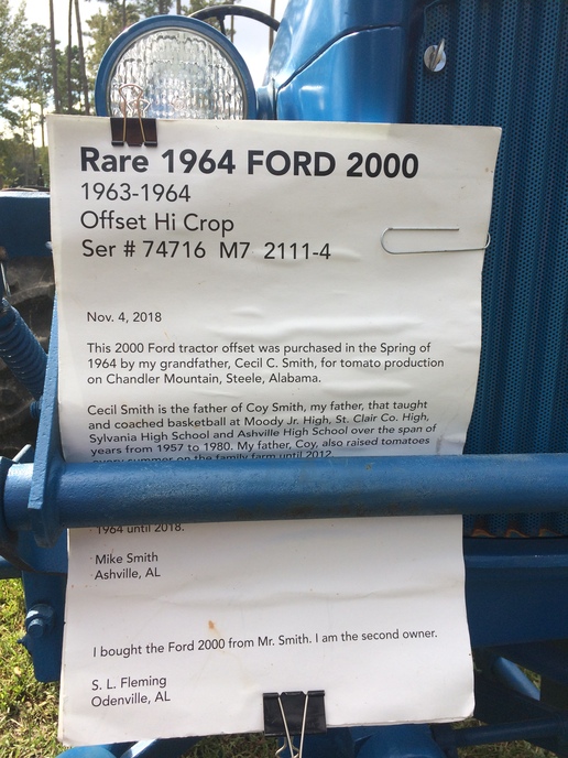

this 2000 always shows up at the show in Gadsden,AL
He's missing a number in the model, but by my sheets
the 2111?-4 would get a 2000 offset (-4) High clearance with wide front
these were built back when Ford didn't want to lose a sale, I think they would have built most anything ordered if they could

 Re: Ford 2000 Offset vs 2000 High Crop Offset in reply to JoeM(GA), 01-27-2023 12:47:28
Doesnt look any different than the offset si posted pictures of.

Ford had 2 versions of the offset tractor. The first Ill call the standard version with 28 inch rear tires. The other Ford calls Hi-Clear which uses 38 inch rear tires. The front axle is the same for both tractors but the center axle is turned over 180 degrees from one to the other which changes the clearance to the ground. The picture Joe posted is a Hi-Clear tractor with the axle flipped over to make it a Hi-Clear model.
