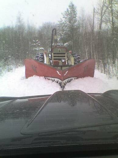

10 working hours ago I installed new plug, wires, cap, rotor, points, coil, and timed my 1959 460 gas. Now when I m plowing at 3/4 throttle, it will miss, cough, and a little loss of power. I run non ethanol fuel, I added heat and sea foam to it. No change. Advise needed.

I ve tried to attach a picture of my 460 and Snowplow?? I have some parts ordered. Next time I go to the Cabin, I ll play with several of the advice given to me. Fuel flow, Timing, Plugs, Cap, etc. the Valves are above my pay grade. So I ll have haul it home pull the loader and tin and haul it to a repair shop. I live in Woodbury MN so I ll pick someone close. Maybe its plugs, I did Installed D21 s. I do run 91 non ethanol gas. Thank you all for your Advise!!

I plow with a V plow pined to the loader with the bucket removed. It s a rough 2 track road through the woods to a remote Cabin. I made the plow sit on 3 skis. Usually I cut the road open and than wing the sides in 3rd.
