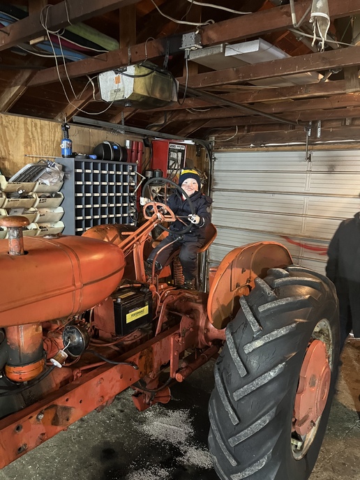

Got the fan hub all loosened up and working good. Put a new fan belt on and all new rad hoses. New alternator as well. Running good with no leaks although Im concerned about the rad. May have to change it out. Time will tell. Grandson was down on the weekend and grampa took him out to the garage to show him his surprise and was he ever excited and happy. Grampa finally has an orange tractor. His favorite color. Every thing seems to be working good but Im not sure about the belt pulley. The pto works fine but the belt pulley does not turn. Cant find a lever or way to engage it. Maybe there is something wrong internally ??

You can put it in and let it turn all the time when driving and running??? I saw a Massey-Harris once with the pulley running thru a parade and still wonder if runs ALL the time without the option to diengage. I would replace or repair that broken pulley for safety reasons-No one should be near it but a jagged pulley is just waiting to grab something??We had a added feature on a WD where the Belt pulley could be engaged-Disengaged with a Knob similar to the PTO knob? Never could find out who made the addition?

When I find a good one I will replace it. Till then Ill just leave it in the neutral position. Some models of Massey Harris run all the time and some dont. Thanks for the response.
